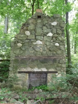

Are you trying to give us some kind of proof that folks stayed warm before EPA stoves????
  • [Hearth.com] Whole House Heating w/Fireplace
BeGreen said:
Can be done. It's woefully inefficient, but this is how houses were heated a few centuries back.
Not houses. Individual rooms. And they had very low ceilings, wooden interior shutters and would keep all hte interior doors closed to try and keep that heat in. Still burned 10's of cords even to heat a tiny house.
