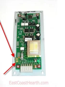

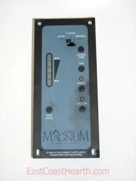

You should have a millivolt T-Stat with a "Swing Setting" set to approx 2.0 Degrees connected to the two screw terminals on the back of the control panel in the lower left hand side as shown with the red arrows. I recommend the Lowe's Lux LTS1500u or equivalent. The Skytechs are nice for a good wireless setup.
If you want the stove to completely turn off when the T-Stat has reached it's set temperature, then the 3 position slide switch should be set to Auto mode. If the switch is on T-Stat mode then the stove will drop to the level 1 heat setting. T-Stat mode is recommended for cold winter days when a low fire is needed to keep the pipes from freezing.
If that does not work, then the control panel is bad and needs to be replaced.
See pics below
