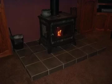

I used steel studs to give me 3.5" of dead air space and then two layers of durock on top of that to support the stove and tile. The steel studs can be screwed or riveted together to make a platform that is non-combustible. I ended up using the dead air space to route my intake air duct. Oversized hearth for sure.

Highbeam said:
njkev said:
Highbeam said:
I was also disappointed in the lack of availability of this product. I couldn't find it. The hardware and building supply companies had never heard of it, and the Micore "dealer locator" was no help at all. Since I couldn't find it I used dead air space for insulation and ended up with a raised hearth. I am actually pretty happy about the raised hearth.
Highbeam,
How did you construct yours using "dead air"? Did you simply use block supporting Durok cement board? Mine is going to be a raised hearth too....but using 2"x6" lumber for a wood frame with 8" spacing between studs. This frame is then covered with 3/4" plywood, 1" Micore, 1/2" or 1" Durok, and then 1/4" ceramic tile.
kev
I was under the impression that you need 3/4" plywood to support the Durok (and anything else above it). The Durok is rigid but does NOT have nearly as much "Ultimate Tensile Strength" as the plywood.
Well, so far so good. Many folks have built the rasied platforms with only the durock providing the support. I wouldn't use a single layer of durock though since the first layer alone wasn't nearly as stiff as after I added the second layer with offset butt joints and a layer of thinset between. Firmed it right up. Adding a layer of plywood would ruin the hearth since the wood is combustible. I used the air space to provide my required hearth R-value.
If you are worried about the stove legs punching through the tile and durock then you could always add some sort of additional supports directly beneath the feet. I sometimes wish I had done that but it's too late. I have had no cracked tiles or grout and my stove is pretty heavy.
