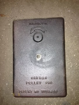

Just cleaning out the fines box and I noticed the cover is heavy cast iron. Nice but look what it says.
Increase
Harman Pellet Pro
see pics below:
The increaser hole is blocked up! It does not need the manual feeder knob anymore. That is good! I tried the manual feeder knob and not to crazy about it, plus the feed rate is varied automatically in room temperature mode.

This cast was and still is produced. This was used along time ago on models that had a feed rate crank like in the pellet pro 2 and some other models that no longer exist.
Thanks
I like it. Good quality.
It's not in a P61, it's in a Pellet Pro unless that's a very early model P61. The control panel looks nothing like mine..

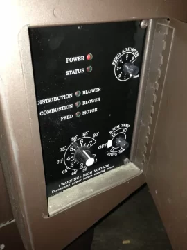

Hello
That control panel above is a Pellet Pro II control panel with the manual feeder knob. LOL
The feeder shaft goes through a hole in the fines box cover.
The hole on my cover is blocked up.

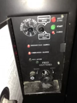

Below is a pic of my P61 control panel.

Uhh I could be wrong...
But the harman feed rate controls the maximum feed rate.
A very important feature.
The stove doesnt know if the burning pellets are falling in to the ash can.
