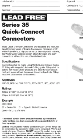

Those are series 10 quick connects which i'm not sure Menards even carries those. Here are the ones Menards carries since this is the internet.
[Hearth.com] Why not to use Watts
Anyways Watts makes different series connectors with different max temperature's. As with anything, get the right connector for what you will be using it for.
Indeed. Nicely done. You'll notice the warranty policy is the same for series 35 and 45...potable water system use only. But you are quite right, the series 35 has a higher temp rating even though it's still not intended for boilers.
