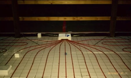

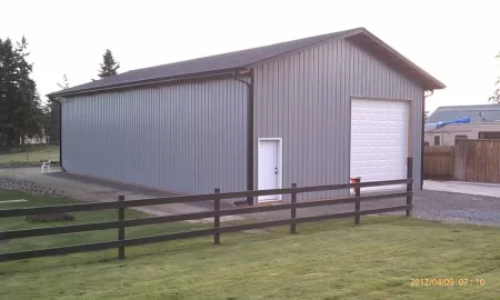

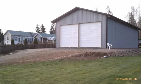

The floor slab is 5" on top of 2" of foam. Pex radiant tubing (1800LF) is in the slab for some sort of legal heating just to keep the barn in the 40+ range, though future owners could heat to 70 for all I care.

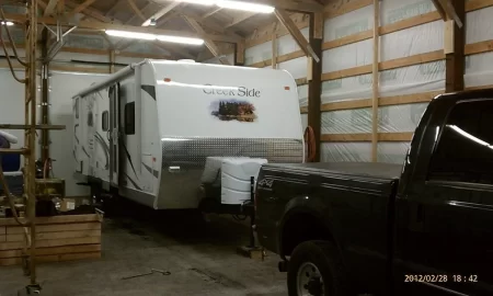

The walls are built with a true 8" cavity which will be filled with fiberglass batts of whatever thickness fits, probably some sort of ceiling insulation. R-20 at least. The ceiling will have blown in insulation. The three 12x12 doors are 2" thick insulated steel doors.
Right now the barn is functional and wired. Being used for storage.

Highbeam,
You Sir....Hats off to You my Friend.....:eek:
That is one awesome "Shed" as You call it...I'm jealous ==c
Have You thought about using a wood fired boiler?
If You have radiant in floor heat, that may be the ticket?
The 2" foam from my understanding makes a huge difference?
Cheers Hiram
I can heat the floors with a very cheap wall hung boiler/water heater or a tank water heater. Well under 1000$. For me, the floor heat is to hold that base temp above freezing at all times to keep the liquids from freezing and condensation from occuring on the metal. The floor heat needs to be automatic and trouble free so propane is the most likely fuel. In the future, if I find myself spending more time in the shed or if the propane costs are huge then I may consider some other way to heat the water. The floor heat allows lots of flexibility in this way. Wood boilers are expensive and illegal in WA. All indoor solid fuel heaters are illegal as well. So if I get busted and need to remove it, the woodstove won't be a great loss.
I like to go to the shop for a few hours at a time. I need a rapid response wood heater to take the chill off. The fisher stoves will be good for this and I already have two of them but the NC30 might be ideal. I'll be installing 6" flue and using the fishers at first.
The shed has been a dream of mine for a long time. I was out there last night until 9:30 getting the Stihl ready for this weekend's adventure.
