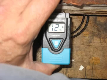

"It is made from dry wood of less than 10% moisture content compared to your best dried firewood of 25%. "
H-mmm... maybe I should stop by with a few splits of my seasoned cherry.

Battenkiller youre probably going to need to soak that cherry so it will burn right ;)
Seroiusly, thats some nice stuff, I got some cherry held back that I smoke/cook with thats nice and dry like that
Battenkiller, I used the 25% number because I figured most people that burn wood aren't going to have stuff at 12%. The stuff I'll be burning was from the big ice storm 2 years ago, but how common is truly dry wood?

I don't have much, less than half a cord for sure. I usually try to keep about a cord and a half left over from last season to get me through the beginning of the season. Got a bigger stove last year, and man is that thing a hungry bugger! Went through 5 1/2 cord compared to about 4 with the old stove, but we're also about 6 degrees warmer on the average, so no complaints here.
I like to mix it in with the less desirable stuff. I always mix wetter stuff in with the super-dry stuff and I think I get better burns than just the dry stuff alone. That's just my own experience, so don't nobody come jumping down my throat saying I'm advocating burning green wood.
Matt, I only mentioned 25% MC because that was the figure the maker of those bricks claimed was the "best" firewood you could get. That figure, however, may very well be the average MC of a full season's worth of wood that actually ends up being run through most folks' wood stoves.
