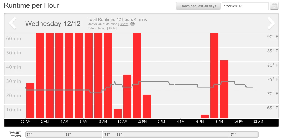

If it helps, I'm using a Lux Geo-B hooked up to my Englander 25-PDV
https://www.amazon.com/dp/B010PTKWW6/?tag=hearthamazon-20
I went with it because a) it works with millivolt appliances b) works with a two wire setup and c) has a programmable swing and minimum run length d) I can use an app to warm my house up when I am gone.
So far it has worked fairly well, but I have learned that I generally only have it programmed to adjust the temperature by one degree due to that fact that I am using my pellet to heat my ranch house. Pretty much that one degree makes my bedroom, which is furthest from the stove go down 3 degrees.
For example: living room is set to 72 degrees, bedroom is 69 degrees. Living room goes down to 71 degree, bedroom moves down to 67 degrees. Living room goes to 70 degrees, bedroom goes down to 63 degree (then I start getting pretty cold).
The neatest thing about it is the graphs. The red shows heat demand on the stove (set to 6) and the line is the temperature. When it isn't red, the stove is idling.
