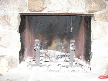

Here's the fireplace.
  • [Hearth.com] Will an insert work in this fireplace, and if so, which one's are best?

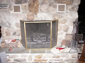

Yea, I did not show them in the first picture but there are two vents that allow heated air to come out and several intake vents on the floor and the side of the hearth.

Heatform. Cut out the damper. If you search my posts, I have a post showing how I cut mine out.
A PE Summit or similar size will fit in there.

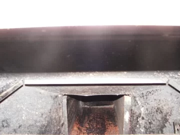

What are the dimensions of the damper opening?
You'll need to get a 6" diameter SS liner thru there...
If your dimensions are bigger than 6x6, you're good to go.

Looking at the damper more closely I would say there is about 6 3/4 inches when fully opened. It would need flexible stove pipe to snake through the front end of the fireplace and then back to the chimney.
