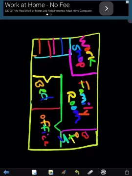

I don't want to put the stove in the bedroom itself. There are a few places I could put it. There's an unfinished workshop that would be an option as well as an office. When coming down the stairs to the basement there is a 90* turn then you enter a large hallway and the bedroom is off the hallway. I've attached an extremely rough picture. The total square feet of the basement is approx. 1,000.

Being a space heater, putting it nearest the space you will be mostly hanging out in (except in a bedroom, where fire codes preclude it) is recommended. The central family room in your drawing would probably be ideal. Will also be contingent on your venting options, ie is that wall above ground / partially above ground? You can then use floor fans to move cold air from the distant rooms back towards the warm stove room.
Are your basement walls finished in your family room section? Concrete or cinder blocks will suck huge BTU's to the point that you made need to finish / insulate them if they are unfinished to keep the heat where you need and want it. Search 'basement installs' in the search box in the upper right corner for lots of prior posts on those.
