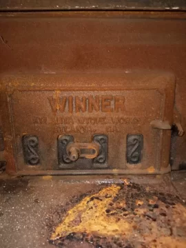

This is a Winner #8316 wood cook stove. It's exceptionally compact and sports a side oven.
[Hearth.com] Winner stove
More info on this stove on Worthpoint
Amazing. Looks like the same stove. Hope all the innards are ok because it looks savable. With a bit of sweat and elbow grease that will clean up ok.

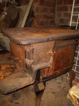

Your stove is beautiful. I'm having to empty the house so was thinking of selling it. Do you have an idea what its worth like it is?
You might be able to convince someone to come pick it up for free, but in that state most people would ask you for money. Restored it might be worth a few hundred dollars, but it is very heavy and difficult to move.

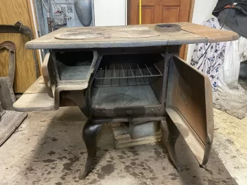

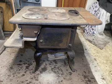

I have this exact stove in storage in my shop waiting to be done. Super cool stove, it was sold as a “camp stove”. Its very light, id say the whole thing weighs 125-150 lbs. Legs remove easily for transport. I paid $40 for it in this condition from the guy who bought it new in ‘67. He gave me original delivery slip from when he got it. The guy is a local guy and said when oil prices went up, him and his wife used it as their sole cooking source for 2 years.

You are not too far off, 750-1000. Problem is, its a very hard resto. Super thin cast, and the whole thing is held together by 18” tie rods. So the cast tends to have brittle spots.

Exactly, and thats why I havnt even started it yet, I wanna get backup pieces, because I can already tell some are going to break. Even the little shelf on the side of the oven broke where the screw hole was through it. Im not kidding, its like 1/8in cast.

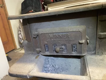

As I mentioned in another thread, I have a Winner, 8316 from ASW.
Mine is missing the fire grate, and I’m told that is pretty important, especially if burning coal.
Also, the legs have been drilled and bolted on, but two broke off.
I bought it years ago, with maybe the idea of warming up the garage in the winter, or perhaps. As a conversation piece in the living room or something.
We also maybe enclosing our patio someday, and it would be nice to have it out there in the winter, if working.
So, what I would like to do is to get replacement legs, and the grate, and get it functioning and nice. I don’t think I would want to sell it then. but I wouldn’t want to make repairs which would lower its value (for my heirs). I saw where someone welded broken legs on, that would be bad, right?
All that being said, where can I get a set of legs and a grate? the grate looks like it would have to be 4 1/2” by no more than 13“. Regarding legs, you mentioned having them recast, where can one get that done? How much would the new ones shrink (would the tabs still fit?)

You would have to look around you for someone who sandcasts. And im not sure about the shrinkage, but I know people have built up the thickness w bondo to offset the shrinking.
