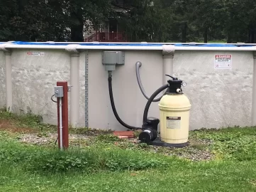

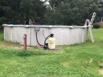

Ok guys, moved to a house that has a 25' x 5' pool. has the attached strainer basket and such. It has a big sand filter. Never had a big pool like this. I live in NY. I think I understand what to do with the sand filter and pump ( except not sure if I bring them inside or not). What I can't find is a convincing answer if I need to drain the pool below the straining filter hole. Some say yes so water/ice doesn't get into the strainer and crack it. Some say no.
Any one here want to help me out here. I think it should be drained below the hole. but idk.
TIA

Safer IMO to drain it below the strainer. Sand filter is fine outside as long as you drain it. There's always a chance you can break the laterals in it by moving it. Pump should be easy enough to disconnect and store inside.

When I had a pool always drained below strainer , drained sand filter and left outside
pump removed and taken inside . Cover add water to hold in place . Go yo go

i drain it down below the skimmer and pull the hoses off if the weight of snow on the cover pushes down the water has a place to go. drain the sand filter leave off the plug and put a piece of plywood or something on top of the sand filter because i take off the valve on top and bring that in. that piece is not cheap. pull the motor inside the shed. i find in my biz that people that leave the pump motor out go thru motors about every 4 years. mine is 5 and still sounds quiet.
