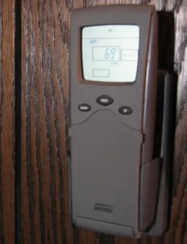

I have a smart-stat-II Remote wireless stat works good I am on second year with this unit.
Remote in and out of the wall mount.
Piece that goes on the stove I keep tucked behind but
put it to the side for this pic.
[Hearth.com] Wireless T-stat
  • [Hearth.com] Wireless T-stat
