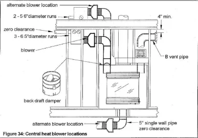

I have a centrifugal 8 inch duct fan down in the crawlspace that pulls air off the concrete floor, across a couple of filters, up through the floor above and into the bottom of my stove. Warm air is drawn back down into the crawlspace at the opposite end of the house. This results in nice warm floors throughout.

No, not the OAK. I have separate outside air going directly to the stove's air intake. This 8 inch duct goes into the bottom of the stove blowing air in between the firebox and the outer shell and exits as hot air through the grille at the front. I attached a pic from the manual that shows the optional bottom duct but I run it in reverse blowing cold air in rather than sucking hot air out.

LL, nice set-up, and thanks or the diagram.
