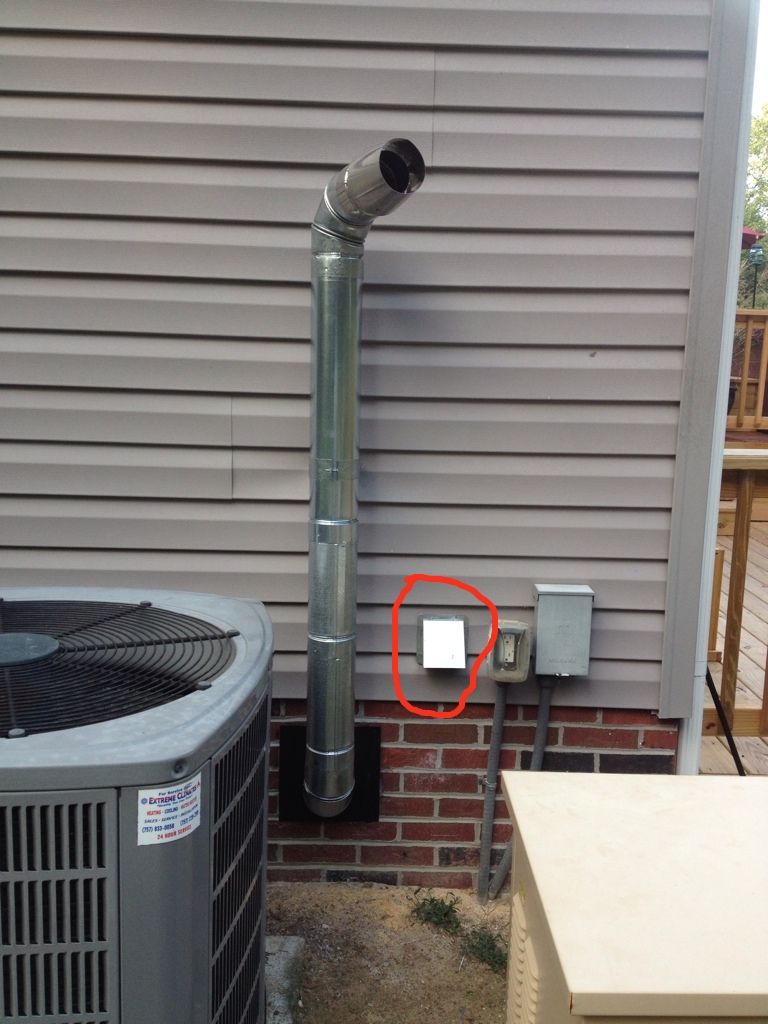

what's up with that OAK (i thinks thats what it is)? Where does that go? How does that terminate? I suspect the stove is quite starved of air if you've only got 1 ton through it and you have that type of buildup. Your glass get dirty within a day or so?
Yes, that is the OAK you were looking at.Flexible 3" pipe. This is what the OAK looks like from the outside.

The top of your vent seems to be pointing up instead of straight out is it an optical illusion or does it point up? maybe you are getting water in your pipe ?
Your right, its pointed up a little. This picture was taken back in August after I installed it. Someone else made the same mention and I have since adjusted it straight out. I'm not sure what my reasoning was for pointing it up in the first place. :rolleyes:

Why would he need 4" for that application?
Just the 3 - 90°'s is 15' EVL. Thats not counting the little horizontal and all that vert inside and out.
If its 10 ft of total vert, then thats 20' EVL (at least).
Max for 3" is 15'
Max for 3" is 15'
Did not know that, I have 3 foot horizontal 6 vert and 2 90's so I'm 4' over. Hmm wish ESW told me that when I told them what I was doing over the phone.
Nothing was never said about the extra for the 90's they were just added in the total footage.
It may be worse than that on the EVL there is that lovely thing behind the stove, the turn to go out then the turn to go up and then the turn before the end cap I count an EVL of 20 just in 90's then you have the out through the wall, plus two vertical sections so I'd guess without measuring 26 minimum.
