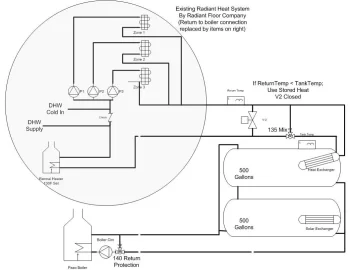

You have what I started with. Mine is an open system, potable water in the radiant loops with a tankless heater. I then ADDED my storage with an in tank HX which heats (or preheats) the water before going through the tankless (I now have a temperature controlled bypass loop which routes around the tankless when the HX output is above my setpoint).
Cheap? Gassification boilers are not cheap. Installation and storage can quickly raise the total project cost to 2X the boiler cost. More if you have to hire a professional plumber. Not meant to scare you away, but that is the reality. The other reality is that heating with propane is REALLY expensive. Electric heat or even better, a hot water heat pump, can be better choices now compared to that propane boiler. I have propane because I want to be able to heat when the utility power is out. I can do that with solar and/or a small generator with a gassification boiler, radiant, propane backup.
If you are thinking you will heat with wood is a year or two, start splitting and stacking NOW. It will be like money in the bank with a wood boiler in a year or two. [Hearth.com] Wood Boiler Advice for New Construction

Why baseboard hot water versus whole floor radiant? You're builder might not be familiar with the latter but up in that area you should have many options for radiant heat. Mark at AHONA served me well - great advice and support. He cannot (and no one else either) have unhappy customers. Give him a call and see what he might be able to do for you. Also, the Radiant Company was excellent on my system design and supplies. There is a lot of labor (time) involved in an under floor radiant but the results are worth it. If you are a little bit handy maybe you can work out doing the radiant install (at least the tubing loops). I installed my system with very little problem. I have about 3500 SF and 6000 linear feet of radiant tubing under the floors. I built with wood web floor trusses to make the install a lot easier. And yes $5K +/- for a gassifier is in the right ball park. Plus installation which can be another 50% to 100% of the cost of the boiler. If you preplan and cash flow is an issue, you can start with the fossil heat source first then add a boiler later (that is what I did). A wood boiler is not acceptable for a primary heat source for most lenders so it is often easier to leave it out until AFTER you close on the permanent loan.
