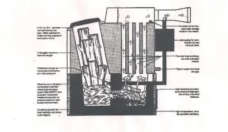

With the Jetstream you have a stick feed system, which I am considering. So the "fuel charge" at any one time is not the total charge in the stove but only the amount in the combustion zone, it's a semi-continuous feed system, unlike other furnaces which are basically batch processors. I have always wondered if this gives a long period of fairly steady state combustion, unlike most systems where conditions change throughout the burn, from gas burning to charcoal burning.
Would using a taller feed tube and longer sticks solve the problem of shorter burn times with your system?
How much do you need to cut down the cross-section of the fuel feed when you get thinner sticks, in order to keep the same burn rate and air requirement? E.g. would feeding 6 sticks of 1.5 inch diameter timber, deliver the same heat and have the same air demand as 3 sticks of 3 inch? That would be only half the cross-section area feeding through but the same circumference. Or have you found some other rule best to apply?

On the fuel moisture - the wood is split and air dried under cover for 2 years then 2 1/2 cords is moved into the boiler room which can obtain temperatures of 100 F or better after a 6 -7 hour batch burn. After several months in the boiler room, the wood's moisture content will not read on the moisture meter. The boiler room is separated from the house by a concrete fire wall and door so no problem with excess moisture in the house.
According to the owners manual, a full charge of hardwood will yield a 4 hour burn. But only soft wood is available in this area.
A taller loading tube would make a big difference.
I split our wood so that three pieces in the fire box would be ideal, but when the wood gets really dry, I only burn 2 at a time. The BTU output remains the same but the feeding interval is more frequent.

The section of the Jetstreams loading chamber the steel section that passes through the heat exchanger is 12 inches in diameter . So as I'm splitting a 12 inch round I want 3 to 4 splits from that round , so when splitting larger rounds its just a case of eyeball to split the right size , have never used a tape measure .
Ideal wood length for the Jetstream is 32 " , the splitter will do 26" , but our pickup can only pack 3 rows of 22" length .
These rounds are 22" in length .

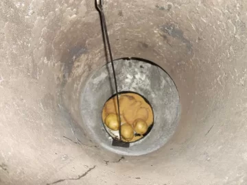

After the fire has been out for a couple of hours!
Shake bake chicken & spuds to be roasted!

Real campfire flavor ![Hearth.com] Wood Burn Rate
Next Rolls!
Done[Hearth.com] Wood Burn Rate
We get the maximum benefit from those stored BTU'S. This firewood thing can be a lot of FUN !;)
