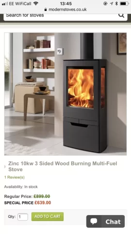

Any advice or suggestions would be greatly appreciated so I can sort the bloody thing out. I’ve attached the type of fire

How tall is "plenty of length?"
From the on-line Product Description:
  • Flue Outlet: Top, NB This stove requires at least 5m of flue to operate efficiently and also should NOT be used with an Anti Down Draft Cowl, only an open cowl should be used.
A sweep told you to remove the baffle? Really? All the heat that was supposed to stay in the stove and ignite the secondaries just went up the flue and cooked the paint off. Might have even ruined it.

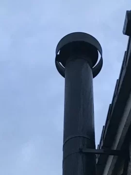

Hi Dasky, there is just over 5m of flue. I have attached a picture of the cowel that’s on

Thanks for the comments so far guys. I’m going to try it without the downdraft cowel at the weekend and see if that helps. If so I will by an open cowel. The baffle is back in place now but performance has gone back to it was before (obviously)

Apparently that cowel isn’t a anti downdraft cowel also so that shouldn’t be the problem.

Am I going down the wrong road considering a spinning cowel?
