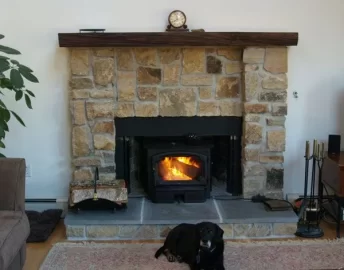

Just put a Lopi Revere into my 42" heatilator fireplace with no problem.
I went with the Lopi Revere in a 42" zero clearance. It needed the SS liner, and it was a tight squeeze hooking it up.
  • [Hearth.com] Wood burning insert for Newer Heatilator
Nice looking hearth, jlinke! It's probably safe to assume that this is the dogs favorite spot.
-SF
Thanks for the compliment SF... The original hearth was a bit too ultra-modern for our tastes. And yes, the dog grumbles at me everytime I come in with a load and he has to move!
Jeff

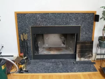

I only have 20 inches of height to work with. Any suggestions on how, or if I'll be able to hook the insert up to the chimney. This may be to tight an area for that to be accomplished. Do you slide a liner in ahead of the stove insert?
The height of my opening was just under 22" and it was barely enough room to get my hands in to connect the liner. Fortunately the liner dropped straight down on to the stove so it was an easy connection.
Is a direct connection from the insert to the chimney always required? Safety is my #1 concern, but this would make it alot easier to hook up.
