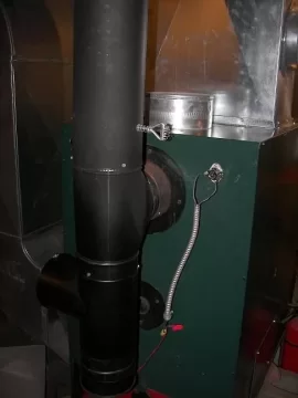

I have been reading about the benefits of using a barometric damper and wanted to try one this season because I'm pretty sure I have too much draft. I have the hotblast 1557 and a T out of the back of it. There's a cleanout at the bottom of the T and the top goes straight out the top, through the main floor and attic. Can I install the barometric damper at the bottom of the cleanout? It seems like it would perform just the same as putting it higher, only this will me a much easier install, won't need to be cleaned as much and can be removed if I don't like it without cutting any pipe. I attached a really fancy diagram to help with my description. Thanks.
  • [Hearth.com] Wood Furnace Barometric Damper Question
almost sure it needs to be inline/or above. look at one and read the specs it should tell you were to install it. any green wood will cause a problem though.
Awesome, the other thing I read was the calibration process, so I have a manometer coming. When the stove gets going and I damper it right down, actually completely off, You can hear the air just blowing right in like crazy and i get 4 hour burn times with a full load..and thats with new gaskets. I'll check his posting, thanks!
You're probably aware that the barometric damper needs to be installed so that the pivot axis of the damper is horizontal, and the face of the damper assembly is vertical? Those are both critical, as is setting it up with an instrument to get proper draft settings. Also, I am not familiar with the Hotblast- do they suggest a damper? Many 'modern' wood appliances are OK with one and benefit from it, but with others, it's a no-no if you have potentially combustible substances potentually going up or accumulating in the flue.
You really need to watch it and clean the flue when needed. Like said on here, it will accumulate creosote quickly. I had the same furnace for years and you really need to watch. I didn't run mine below but about 1 foot up on the furnace. If you put one in, also put in a manual damper above it incase of a chimney fire. It helped our furnace alot and was recommended, but they do accumulate quickly. Thats with me trying to burn hot and clean with my old furnace.
This is a quote from my furnace's install instructions: "Do not attach draft control to top or bottom of flue, pipe, nor in a room separated from appliance. Best location is as close to appliances as possible." (broken link removed)
I was told during my install (which looks just like yours) just above where you have your T would be best.

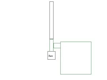

So, in reading this helpful forum, I started looking around the house. I have 2 CO/Smoke detectors made by BRK. Never heard of BRK, so I bought a kiddie CO2 meter/alarm with a digital numbered display, so I appreciate all the info and advice. I have a magic heat, I bought it brand new and used it for about a week. I can't remember why I got rid of it, but I remember reading on the net that some people's insurance companies were threatening to cancel their homeowners policy for using them. Usually insurance companies have lots of facts on accidents, risk factors ect so that alone tells me to stay away from them. Anyhow, my baro damper is installed. I have not got the oil in the manometer yet to set it, but I set it so no smoke comes out of the door for few trial fires. I have a nice blue flame and it's not getting pulled up into the chimney, it's staying below the baffle. I have this blue flame because I'm now able to remove the rear plug which lets air into the firebox behind the firebricks. If I opened any air inlet like this before, I'd have a 600 degree chimney in no time. The baro is letting a lot of air pass and I have a really hot fire and my blowers are running constantly..with 3 pieces of wood which is not like before. I have 2 "peek" holes in the hotblast I look in through and I can't get anywhere close to look because it's so hot. Long story short, I think I'm going to like this winter much better and use a lot less wood. I'll check my chimney more as suggested. Thanks for all of the input. Hey, did you guys hear about the guy who uses a magic heat in his sawdust burner?

FWIW, BRK is a good brand - they are the makers of one of the major consumer brands - I forget which off hand, but it's a well known one. BRK is the same units with a different packaging for the commercial electrician trade. Apparently the idea is to sell to the pro's at slightly less than what the consumer brands cost at HD or equivalent, and then let the pro's sell to the consumer at a healthy markup for the "commercial quality" units...
I have BRK's in our house, purchased from the local electrical supply house... MA did the wonderful thing of passing a code requirement for a style of combinatin CO/Smoke detectors that nobody was making at the time, and I was bugging the heck out of the various manufacturer support lines trying to find something code acceptable. BRK was the first people to come out with them, and I literally got some off the FIRST truckload shipped after they got their UL approval and started production...
