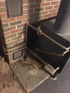

I have just purchased a house that has a oil furnace as well as an add on wood boiler. Everything was working fine until I had a freeze break out in my shop and then all hell broke loose. I had the pipe repaired. The plumber I used didn't bleed the circuit properly and I believe the wood furnace portion of the circuit was air bound. All the solder was burned out of the joints. I had that repaired. Now when I use the wood boiler I have this terrible bang noise and what I think is kettling. Hoping that it was air I bled it again to no avail. When I turn the circulator off for the wood stove the kettling or whatever the noise is ceases almost immediately. The plumber I am using says it may be a bad circulator or a bad flow check. I'm sure you will need more information or pictures and I can get those rather quickly. I just want to put this to rest as heating with oil was not in my plans. Any help would be wonderful. Thanks I'm advanced.

Valve closed on the intake or discharge side of the pump right now? I can't tell which way the pump is pushing from that side of the pump. Fix the solder joint break right now if the system has no water in the line because your going to have to drain it again to fix that joint. I would swap that pump with one of your other pumps from the oil boiler. Looks like they have isolation valves on both sides of the pump to make pump swap easy. That will tell you quickly if it's the pump or flow check.
Seems to me that piping on the back of the wood unit would be very hard to get air out of, there's a high spot with no air vent. Usually to purge air, you'd hook a feed hose to that bib down low, then hook another hose for water and trapped air to get out, to another bib that was all the way around what you're trying to get air out of from the first bib. (That sounded confusing). But not having a vent at high spots can make even doing that hard sometimes. Sounds like there'sstill air in there somewhere.
