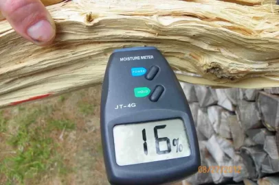

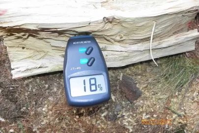

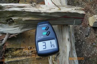

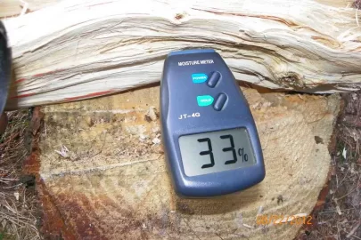

I took a reading from the biggest split (18 percent) split that then took two readings (31 & 33).

  • [Hearth.com] Wood Identification

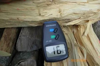

From 31 & 33 percent on 8/22 down to 16 on both splits, tried to get the prongs in further but the elm is harder than a rock.
