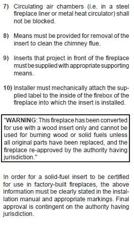

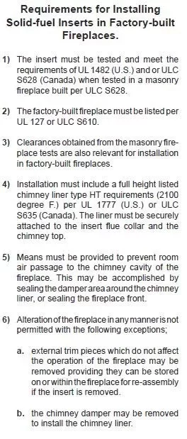

That was my thought. Here are the requirements for installing an insert into a ZC fireplace. Click to see full sized.

whose specs are those I am curious. because I would love to be able t do this for customers but I have never found any agency that would say it was ok. can you give me the reference please so I can possibly use it
They are from the Regency 2400i manual. The Avalon Rainier gets more specific about requirements including zc fireplace brands that are acceptable.
[Hearth.com] Wood Insert Sizing Question
ok are those listed zc units ul tested for the insert to? I only ask because in my csia training and testing they dealt with this issue exactly. and they say that unless each of the units have been ul tested for that specific application we will be held liable for any damages resulting from any malfunction. their contention was that yes there are inserts and liners that say it is ok to put them in a zc unit but the zc units or their chimney systems are not listed for that purpose
I really am curious because if they are both listed I would love to do it. but I hanvt found a combination that I was comfortable with the liability issues yet.
Sounds like a misinterpretation. The ZC inserts need to be tested to UL127 or ULC S610 to be qualified according to Regency, not tested for each specific application. You can be darn certain the stove mfgs. have examined liability issues with a magnifying glass.
I just checked Quadrafire's insert docs for the 3100i and they echo Regency's guidelines. PE and Napoleon are similar.
yes but csia's argument is that modifying the existing zc unit makes it not meet ul127 any more. and in ul127 it says that you need to use the internal grates supplied with the unit in 7.14 and that you cannot modify the existing damper. also zc units are only required to support 100 lbs per sq ft and I know many inserts exceed this
