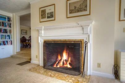

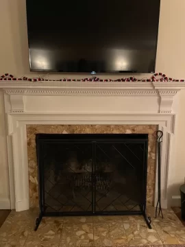

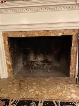

I am looking for recommendations for a wood insert for a masonry fireplace for a house in New England. I have looked at the shops locally but have not found anyone terribly helpful and so I am a little overwhelmed in choosing between so many options. The insert will be installed in a family room that's rather large, about 800 sqft. The house is a Colonial-style, typical New England style house that's about 4000 sqft. My primary purpose is to offset the cost of heating with propane. I don't expect to heat the whole house given the size of it, but would be nice to spare as much propane as I can. We have plenty of hardwood to go around. The fireplace is large, 48" width, 34" height, 24" depth. The hearth extension is stone and it's 20" depth. To match with the style of the house, I am looking for something traditional, not modern. Most of what I've seen in stores seems small for the size of my fireplace--I want to avoid having a tiny looking firebox with more surround paneling than actual fire. I have been looking at large fireplaces, but I am not certain how big is big enough, and how big is too big. Given that the insert will be in the family room, with a TV above it, I want to be comfortable sitting on the couch a reasonable distance from the insert.
Thanks in advance for the input. I'll attach pictures, with measurements given above.

To go with the aesthetics of the house, I have decided to go with enamel. Having said that, it seems that there aren't that many large wood insert options for enamel. And so I have started to narrow down the list...
What do people think of the Clydesdale from Hearthstone versus the Alderlea T5 by Pacific Energy? If anyone has any other recommendations for large, enamel wood inserts, I would be appreciative. I'm aware but not as interested in Montpelier II and Ashford 25 (the Princess is great but doesn't come in enamel).

What is your chimney like? The T5 is a great stove and an easy breather. I don't think I'd want it on a very tall chimney. You may even want to look to see if the T6 would fit. With that size room, I doubt it would be a problem provided you can move cold air in from other rooms.

The PE T5 will provide a better experience. It is able to load N/S and the air control is run by the user. Get the blower to convect heat out of the fireplace. Install a 6" insulated liner and insist on an insulated block-off plate in the damper area.
