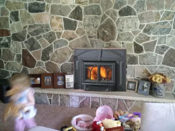

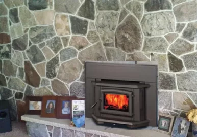

I have tried to super-impose the stoves onto an existing picture of my fireplace. Not the best, but really give the general idea.
Having a tough time picturing either in there, so this was my best option.
Anybody have opinions, our house is torn between the Jotul C450 and Pacific Energy Pacific

the jotul looks great, but i think the pacific will give you the best bang (burn/ heat output) for the buck
What are your plans for the rug in front of the hearth? Since your hearth is raised, you might be able to get away with just ember protection. I think it will depend
on how strict your inspecting authority is.
