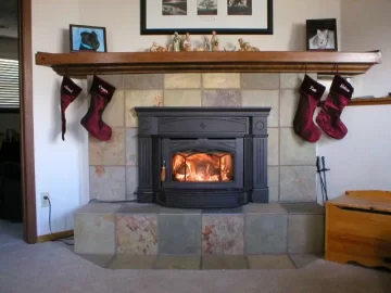

Oh yhe I forgot to mention hooking the flue up. Regency makes this nifty little item that allows you to hook up your flue from the inside of the stove. You have to drill two holes in your liner collar and put a bolt across the middle. Then a hook shaped bolt hooks on the bolt across the collar. You then add the third peice after you've pulled the liner into the stove collar. I few wrenches of the nut and the whole mess tightens into the stove collar. Pretty slick stuff cause I could 'nt get my hands on top of the stove. With an offset flue adapter I made the impossible possible. Oh and I took one look at the flue hookup kit at the dealer and made my own in about fifteen minutes using some 38th'' all thread and some nuts and washers. with some funace cement you will have a safe secure conection to your stove much better than some screws.

Have to comment on the Osburn here since I own one. I know what you mean about the looks, I felt like it looked a lot like one of the generic bay window pellet stoves out there when I saw the pictures, but all other factors point me at it, so I caved on the looks. Now that I have one, I find the view of the fire with it to be just amazing. It's the best out there for a good view. The glass gets a little dirty on the bottom corner by the door handle, but I'm not convinced that I have the door sealed perfectly yet. I reccomend you take a look at one installed if you can before you give up on it. We really like ours. The inserts I find look nicer are the VE Winterwarm large or the Regency (not sure model) but neither will fit. Take a look at my picture over in the Picture forum. If you like I can take a full resolution pic and email it to you off line. Not trying to sell you on it, as I think I personally would have gone with the Lopi Revere or Pacific Energy Vista if I could have gotten one. Upside is the Osburn was a LOT cheaper than the Revere assuming you account for blower, and the fire view is much better than both.

Thanks, yes, the Regency does look better installed, that is a very nice install Warren. I do ceramic tile, and your installation looks right on the money! Jared the Hampton loks good also, but looks expensive! To rich for my blood. Are you saying that I can use this regency adapter on another brand of stove?
