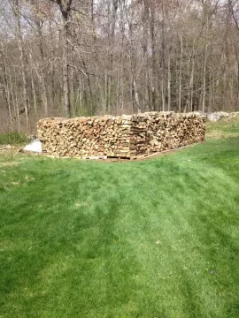

My stack back in April prior to being covered. I guess my expectation was off that it would be good to go for this winter. It is double stacked with space in between. The ends have some drying, but the centers were very wet. Also my splits may be too big.

Double-row with space isn't bad but yeah, splits look pretty big. Then if you had a wet summer like we did here, drying is slowed further. Lotta work but you could go through the stack and separate the non-Oak and smaller splits, re-split the soft Maple or other fast-drying wood, and you might get away with burning it hotter in your pre-EPA stove. Or mix in some bio-bricks. You would still have to check your chimney often and brush as needed. Not too hard to do if you have a liner.
Also most meter readings get pretty suspect once they into the mid-30's.
I would expect to see lower readings on the ends facing the sun, but if that is oak (looks like it but pretty far away) I would expect it to take a couple years to dry split that big. Or any of the denser hardwoods.
Nice looking stockpile you have. Hardwoods css that size in April would be a miracle to use this season, next year you are pretty much golden. To be certain for next year, it might be wise to take a portion for further processing. Resplit and stack with more surface to air than what you have now. No matter to specie, the smaller the split equals quicker drying.

Thanks for the responses. The land behind is not mine and do not have permission to use or go on. Yes the wood is stacked on pallets. I will do some more tests tomorrow on some more splits. Looking back on it, I should have left the wood uncovered for most of the summer, because it hardly rained, and I should have split smaller. I might sub-process some of it.

Wow nice stack - Even cooler that's its premium oak,
The stacking method that you use is a great method, the only thing that is bad is that its to deep. Next time take your pallets and make single rows, stack only (2) rows on a pallet. There's a member from Alaska (pointdexter?) that has some good pallet stacking pics, he starts off wide on the bottom and makes an upside down V about 4.5 to 5ft high, this helps with air movement, also when the time to top cover comes you have an automatic slope for rain / snow to fall off and drain away.
