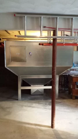

I am also installing a Biowin. Are you installing a bulk storage? If you are thinking about it you may want the talk to Vermont Renewable Fuels, Inc. I bought a 4 ton bulk hopper from them and they have great customer service. It is a really high quality, well-made hopper.
If I lived closer I would be buying my pellets from them, I believe they have Vermont wood pellets in bulk, which I hear are good.
I'm not getting a bulk hopper. If it worked out to actually save me money with the NH $6000 rebate I would but the last time I looked at the numbers it appeared to be cost prohibitive.
