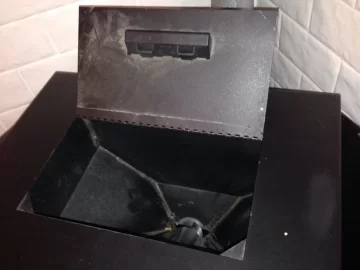

I'm worried because I see no gasket on my hopper lid as you describe. Does this look right?
  • [Hearth.com] Wood pellet Stove Auger Bushing - Brass, Plastic - Which do u have? How do u Lubricate?
