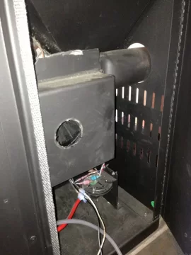

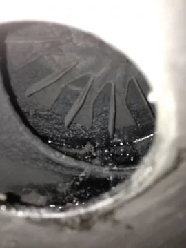

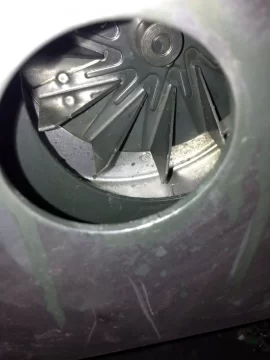

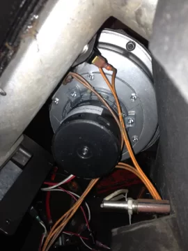

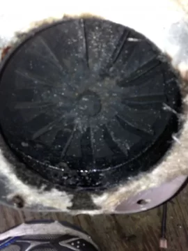

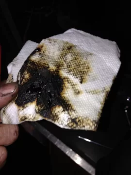

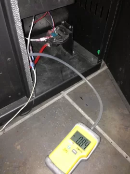

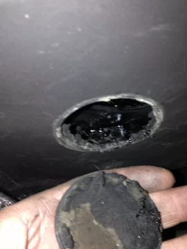

Put the manometer on the hose barb behind the fire box and got -0.27 wg after cleaning out the top of the upside down horseshoe ash chamber. So I cracked the cover to the exhaust plenum and to my dismay saw some very shinny creasote. It looks real sticky because it is real sticky! See pics.
I removed the combustion blower and got out the Acetone and paper towels! Then some dry moly when clean!
I do not see this very often. I know bad pellets can cause this. Could there be any other cause?

The interesting part is the fact that it was most liquid at the bottom of the round exhaust plenum. The ash chambers and other parts were dirty with ash but not shinny and goopy like where it is in the pics.

Therefore the fact that creasote has built up in front of the original 85 CFM exhaust blower may be telling us that the new upgraded 105 CFM exhaust blower is truly needed here. After installing the upgraded blower, the manometer read -0.84 that is approx .55 difference! Interesting I only read 0.62 at first but then I realized the firebox door was not shut tight. LOL Also there was no change in the reading when the new ash pan door gasket was installed. I still have the original door gasket but I plan to change that and take another reading.
I seems now this 7 year old stove will work better than it ever did before!

As the gases cool(further in the system).... The goop starts where it cools enough to Sote up.
SOTE in box? Nope. Sote in plenum? Yep. Cooled gases. Add in that Babys burn Chitty? And it all makes sense

Also water versus acetone......both work on creosote- water is cheap, but can cause rust...acetone is more spendy, smells, and cause cancer (but arguably works faster)....we use soapy water

Since I must use Acetone to cleanup good before painting, I have plenty around. To me the Acetone is much faster and for $7 a can that lasts a long time, my time is worth much more! I also have one of those painters breathing masks. The ash chambers in this baby were pretty clogged when I brushed and blew them out with compressed air. That buildup could have been the change that trigger everything. The new upgraded exhaust blower will help. Proper installation and proper maintenance is the only way to keep any stove running well.
