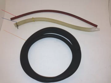

The picture below shows:
1. 4 year old Enviro vacuum hose on top shown by a red arrow.
2. 2 month old Englander vacuum hose shown by a blue arrow.
3. New 7/32 car vacuum hose shown by a orange arrow that is the same size as the pellet stove hoses.
Does anyone have a preference? What is the best? What will last longer?

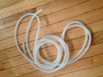

I just got the High Performance Silicon Thick Wall vacuum hose and it is really good stuff!
I was working on a Baby CountrySide stove today and replaced the hose that was getting hard and also a tad loose where it goes into the back of the firebox. I asked the owner if she had any problems and she said yes, it would shut down for no reason sometimes! I said this will fix it!
