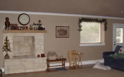

I am leaning towards a log burner at this time due to cost, heating needs, and I don't think I could find anyone out here to service it. We have all the corn I could want to burn but I have seen here that it seems to be important to have someone close by to work on them.
It will go in our living room which is about 30 x 28 and is open to our kitchen which is about 21 x 20. the opening is 39" x 37"

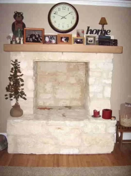

Looks like a nice fireplace to start with, an insert will look really nice in that opening, whether it's corn/pellet or wood. How is the local wood supply BTW? What kinds of wood are available, and how plentiful is it? I know some parts of Texas are fairly barren desert, while other parts are more wooded - which are you in? Are there enough cordwood dealers in your area for you to get an idea about the costs of wood?
In addition to the opening, it is good to know the depth of the fire box, and the width and depth of the hearth in front of it. Also I noticed a fairly large mantle in the picture, how far is it from the top of the box to the bottom of the mantel, and how far out does the mantel come?
I see possible issues with your Clearance to Combustibles (CTC) numbers in both cases - this is solvable, will just need a bit more work.
How big is the flue, what is it made from (is it clay tile lined?) and is it inside the house or does it run up the outside of the wall?

Let's see ...avg amount of wood in my area
A cord of seasoned oak sells for $125.00 (delivered and stacked)

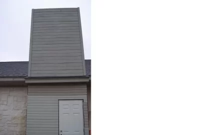

Firebox is 38" deep / Mantel sticks out 10" and is about 9" from the bottom of the mantel to the top of the fire box...
We did not build a true "flue". It is a Stone box protected on the outside with a big storage room and a "fake" Chimney . I can go out the back or the top.

Thats a good price, though you may want to check out some of the threads around here about the differences between what you and I as customers would consider a cord of seasoned wood (128 cu ft @ <20% moisture), vs. what the wood guy's tend to sell as a cord of seasoned wood.( <128 cu ft, and doesn't still have leaves growing on it)
That is a nice deep box, you shouldn't have any trouble findin something to go into it and be pretty much flush with the front of the fireplace. However you may have issues with that mantel, it might need to be moved or have a heat shield installed under it.
So how does the smoke get out of the fireplace now? Or are you saying it is currently a purely decorative, non functional unit? If it is a decorative unit now, you may have some problems, starting with determining whether the box would be NFPA code compliant if you tried to put an insert in it to start with. (Inserts can only be installed into compliant fireboxes in reasonably good working order) Primarily the concern would be the clearance between the back side of the masonry and any combustible materials (wall studs and so forth) Also how heat proof are the materials the box itself is made out of? It looks like painted stone from the pix, but not all stone is suitable for use in fireplaces, and neither are many mortars.
Assuming the box is OK, I will let the experts take over on the details, but my first guess is that you would need to come down from above with "Class A" pre-fab chimney itno the top of the box, and going up the inside of that fake chimney. Again, lots is going to depend on exactly what things are built like inside as to what will be possible and what it will take to get a code compliant (safe) install.
Given that you might need to put in some sort of chimney, a pellet / corn stove might be easier as they aren't as difficult to deal with in terms of venting and exhaust. You would probably be able to just drill out through the back of the box and vent out the wall of the utility room.
