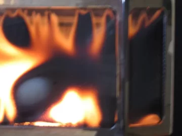

I made the mistake of dumping in a couple of cold bags of wood pellets in the cold garage. Approx 40 Degs. The heat was not so hot and more ash in the burn pot!
So is the best way to Warm the Moose? Maine's choice in this case. LOL
Do warm pellets produce hotter heat?

Hello
See pic

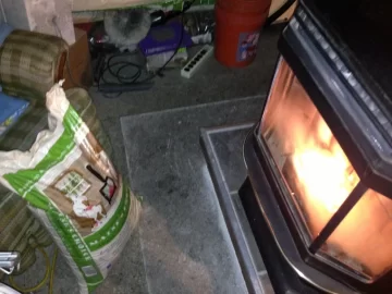

Yes, I stored them in my garage and where I store the snow blower on the tractor after each storm. The snow melts off and pools so the garage is cold and very damp!
After leaving them in the warm dry basement for a day they burn much better!

Storing them in the basement from the start would be the best arrangement. When they get moved from the cold, damp garage to the basement, you not only lose energy warming them up again, but you also lose energy evaporating any moisture they bring with them.
Of course, if you need more humidity in your home, during winter, the moisture may be welcome. Here, in New England, winter air can be painfully dry.
