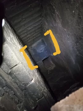

After removing some of the smoke shelf to make clearance for an SS liner for a new insert in my fireplace, I was able to get a better view up inside the smoke chamber. With this better view and cleaning it out up there I noticed wood planking at the top of the smoke chamber! This fireplace is in my basement with another fireplace directly above it in the same chimney on the main floor of the house. This is directly below the flue and smoke shelf of the main floor fireplace. What the heck is this?

Looks like boards used as forms. They need to be removed

Is it possible it’s the imprint of the boards after they were removed?
Possible but it doesn't look like it. Regardless you need to check it

I was thinking the same (imprint). Knocking it with a metal rod should tell you whether it is wood or not

It's definitely real wood. I panicked for a second thinking that it was the subflooring of the main level before I realized there was no way that was possible! If it's just forms that were left in then I'll just dig them out. It's an awkward angle but I'll figure something out. Crisis averted.

I was able to cut it out today, rigging up the tool took much longer than the cutting operation. I used hose clamps to secure an oscillating tool to a 5ft paint roller pole and was able to just barely reach it. I cut the pieces down the middle and most of it just fell out. One last piece was a pain but managed to wiggle it out with a flat bar attached to the pole. I had the oscillating tool plugged in to a switch-controlled outlet box so I could turn it on and off without having to reach up to the tool. The cheapo blade obviously didn't survive.

Its just over 8ft tall from the fireplace floor to the top of the smoke chamber where the wood was at. I had already chiseled out some brick and cut out the damper to make room for the liner so I had about 6 inches to get the tool up there and hang on to it. The actual cutting only took a few minutes and another ten minutes or so with the flat bar to work out the stubborn pieces, not bad at all for someone in the same situation as me. The house was built in 1950, that wood had been smoldering for over 70 years.
