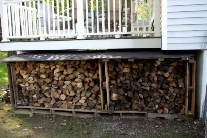

Picture of my "shed", made from pallets and some scrap plywood - basically free. Holds approx 3/4 cord and is right next to my garage. Provides a close by and dry stopping point for my woods trip to its meeting with the heating machine. Gets reloaded when needed and time permits during heating season. Woodland currently holds 24+ cords of stacked wood.
