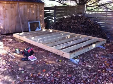

I'm in the process of building a wood shed and had a few questions and I'm wondering what people think. Looking through some past threads it appears there is little consensus on anything :-), but I thought I'd ask and see what people think.
Shed is 8'x12'. I've used PT2x6 as joists, sitting on two PT4x6 skids atop concrete blocks. I'm in the process of figuring out what to do with the flooring. I plan on using PT decking 5/4x6, but was thinking whether there were benefits of leaving a couple of inches gap between each board for air circulation, or should I just deck the whole thing? I'm wondering whether the additional air flow is counteracted by upward movement of moisture from the ground. Thoughts?

Would appreciate any feedback. I've attached an image of the floor structure as it currently stands.

And now that I'm thinking about it, would I benefit from additional support under my 2x6's in the middle? Right now I have a span of 6' between skids and my joists are 16" on center. So my 2x6's are spanning 6' unsupported. While it's open, it's easy to add an additional skid down the middle resting on three more blocks, but once that decking goes on it's another story.

I would most definitely beef up your floors with some cement blocks in the middle . . . also . . . were joist hangers used? The flooring holds a lot of weight . . . I am not an engineer, but I am a firm believer in over-building stuff so I don't have it break and have to do it again . . . since I am also quite lazy.
Thanks, firefighter. Lots of good info. There are not joist hangers, but then they are not hanging on the rims joists, they are sat on the skids, although I guess the hangers would help with sideways movement or twisting. I think I'll def. put an additional skid through the middle - I want this to last 15+ years, so money well spent I think. At the same time, I'm kinda going off some plans I bought a while back, and they had a slightly smaller span and didn't have hangers, a third skid, and also sued 2x6s. But for a few bucks and time, worth doing. And I had also thought of all the crap that could accumulate underneath over time, so maybe no gap is better.

I would beef up the floor for sure, I filled my shed the first time and broke a couple of joists. Had to remove 6 cords of wood and support the floor with poured concrete. I left the back off mine so I can load and remove wood from either side. I also put a divider through the center so you can remove wood from either side. I have sides on mine up to 6 ft, that makes filling it much easier. Mine holds 2 years with of wood so I remove from the front one year and the back the next.

1) That shed will hold, potentially, 6 cord. Each cord weighs 3800-4100 pounds. That's a lot of weight. Which is why I would have gone with pallets set on the ground.

I'm looking at storing just over 4 cords, so less weight, but I get the drift. I already plan to add an additional skid down the middle of the joists for added support. Jamaica Cottage up in Vermont make some great looking sheds (and woodsheds) and their plans show 2x6 joists on skids for sheds that hold similar amounts of wood, if not more, than this will. However, I'm going to air on the side of additional support as it'll only cost me $40 extra.
