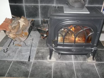

So whats the concern here that the wood will ignite, or what? I store a small amount of wood next to my stove, and a bucket full of kindling on the other side.
We know that, and we have been waiting to use you as a bad example for what happens to those who don't maintain clearance to combustibles. ;-)

I am supposed to be scared of that wood catching on fire, very funny
We got time. :cheese:
I will wait till it sizzles or hisses or whatever these folks say they do its Oak

cptoneleg, we're not talking about your arrangement here, which doesn't look that bad to me...I have wood placed pretty much the same way near my stoves, and after watching the situation carefully through a lot of burning, I haven't had a problem. But we haven't yet seen any pics from the OP of the setup in question. It may be quite different (and more dangerous) than yours. I'll tell you that after we first moved into our home here in Oregon, I was burning in an old existing Lopi M320 or 520 or something (long gone now). That thing would put out some serious heat. I had an old copper washtub full of splits stuffed in vertically, and an armload more laid horizontally on top. The tub was sitting such that the end grain of those splits on top were probably only about 4" from the side of the stove. I loaded the stove up for the night, got it burning good, damped it down and went to bed and went to sleep. I woke up sometime later (thank goodness), smelling something I didn't like. I got up to take a look and I found the ends of the splits closest to the side of the stove charring and smoking. Not talking about sizzling here...this was dry Lodgepole Pine just about ready to burst into flame. Scared the bejeezuz outta me! I moved that wood well away from the stove and I've been real careful with all that CTC stuff (beyond stove installation) ever since. Yes, the manufacturers' numbers are real conservative and might be safely fudged a bit...but it's not something I want to test in my own home again. Rick

Holy crap Rick, I been burnin wood for 40 years and still doubt myself. I just posted on another thread why I used double wall and it wasn't because I needed it to meet CTC....Way to go......I'm not going to sleep tonight....hope you are happy. :ahhh:
Exactly no picture, whats to talk about, would have really liked pictures of the rats, on another post someone had their couch closer than my wood. That wood in that little rack is rocket fuel, I wouldn't think of keeping it there if it was dangerous. But thanks all for the concern
