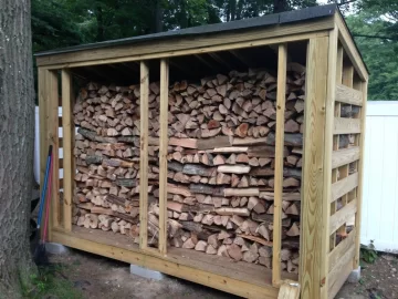

so, i'm about to enter my first year burning. just built my woodshed and stacked it with 2 cords. hoping the wood will be seasoned enough by Nov/Dec.
I expect to burn 2 cords/year (nights/weekends). my year end goal is to have 6 cords stacked. stock up now so I only have to replace my used wood each season, and will always have 1-2 year seasoned wood waiting each following year.
but the question is how is best way to store a 3 year supply of 6 cords? I built my wood shed to fit only 2 cords. should I build 2 more sheds? or just single stack, no roof? I live in Mass with lots of rain and snow.

Seems like most here stack outside for a couple years, then move into shed a month or two before burning, but after a dry spell.
What kind of stove, how big is your house, and will this be your sole source of heat or supplemental?

It all depends on your personal preference and space that you have. A lot of guys on here fill their wood shed with what they are going to use that winter and the other stacks on deck for the shed stay out. Some top cover some don't. Wood is not a sponge but top covering may be your preference if you have a lot of rain. I don't generally cover anything except about a cord on the patio and then replenish as needed through out the winter. Where ever you decide to stack sun and wind is your friend (especially wind)

Buying the Lopi Freedom insert. for 1700 sq ft ranch. i'll heat wood supplemental (nights/weekends) and keep the oil thermostat low at 60 during days while im at work.
For 6 cords, I'd build a wood shed.
Nice to season it outside for a year & then to the wood shed until needed.
2 to 3 year old, dry woodshed kept wood , will be real dry & a treat to burn.

If you can stack the wood outside, that is what I would do, then move it into the shed before you burn it. A shed is not really necessary, you can top cover with tarps, pieces of roofing, or not at all. I can stack a week's worth inside close to my stove, and an additional cord or so under my deck so that I always have dry wood on hand. If the wood is seasoned though, it won't take long to get rid of any moisture it gets from the rain and snow. It is important if it is stacked outside to keep it off the ground though. You'll have fewer bugs in the wood and it will dry faster. Pallets will work, and I use some, but you can also use longer pieces of wood to make your rows. Good luck!
Agreeing with everyone else, only put the wood in the shed after it is dry. No significant breeze is going to penetrate very far into a big, solid block of stacked wood like that. The stuff around the outside will dry, somewhat slowly, but the stuff inside is going to stay wet.

In Mass, similar rainfall and climate to my own, stack outdoors for a year or two. The wind and sun will give you the fastest possible drying. Then, move what you need for that winter into the shed mid-August, before the big rains (hurricane / trop. storm remnants) start rolling up the coast.
Since it looks like you have some freshly split wood you want to burn THIS year, you'd do well to pull it out of the shed and stack in single rows in the wind and sun for the next 6 weeks. This ain't gonna get it all the way to where you want it, but the first six weeks is much more critical than the second six, and so on...
That said, nice shed! I'm 2 years in this place, and I still don't have one. <> Too busy dealing with rotten window frames and sills to have time to build a shed.
Building a prototype takes longer. If you are sure you will stick with wood heat, plan on 2 more sheds. My sister and her boyfriend built 5 mini sheds holding a cord each. We burn 5 cords per winter.
She has the current year under shed and next years is along the fence waiting. The mini sheds top cover a platform about the size of 2 pallets.
Her design was based on extremely limited backyard footage.
You could plan for 2 more sheds as you go about your other chores and think as you go.
Or like me just stack out in the open air, lol.

Brakatak, I don't think I've welcomed you to the forum yet so consider this a warm welcome.
First, I do like your wood shed. Looks like you did a very nice job with it and you'll really appreciate not having to get snow off the wood before bringing it into your house.
Second, like others have stated, it is normally best to stack the wood outdoors first. The reason for this is that wood has lots of moisture in it and we have not yet figured out how to burn water. You no doubt have heard that most wood needs a year to dry before being burned. In practice you will find that this figure can vary a lot. Some wood can be burned within 6 months after being split while others can take up to 3 years or possibly more. So one of the first things to be determined is what kind of wood you have and when was it split. Count the drying time only the time after it was split and stacked. So if you can let us know what wood you have and when was it split and stacked, we should be able to give you a reasonable answer as to what to expect with the wood you already have.
Should you remove it from the wood shed? Ideally, yes. However, I would not go to all that work and just live with it and take it as one of the learning steps to burning wood.
The best way to store a 3 year supply of 6 cord of wood? This is how we do it:
First we do all our cutting after leaf drop and usually start around December 1. We cut off and on all winter and sort of stack the rounds right where we want to stack the split wood. In the spring after snow melt, normally in March or April, we then split it all and then stack immediately right there. In the picture (From April 2009) this was around 9 cord of wood. Under the wood we had cut some saplings in the woods (3-4" diameter) and laid them down to stack the wood on. We then left this wood exactly as pictured (except we cleaned up around the stacks a bit) until the following November. At that time we covered most of it with old galvanized roofing and threw some of the uglies on top to hold the roofing. One stack we covered with old rubber roofing. And by the way, most of this coming winter's wood will still come from these stacks.
In October, we move 2.5-3 cord into the barn and that is the wood we'll be burning through the winter. This has never failed us and usually we have our wood in the stack for at least 3 years or longer. Occasionally we'll burn some 2 year old wood but we always can tell a difference between 2 year old and 3 year old wood. Even with white ash, which some foolishly say can be burned immediately after cutting. We can notice the difference between the 2 and 3 year old wood....even when we are cutting dead trees!
