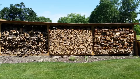

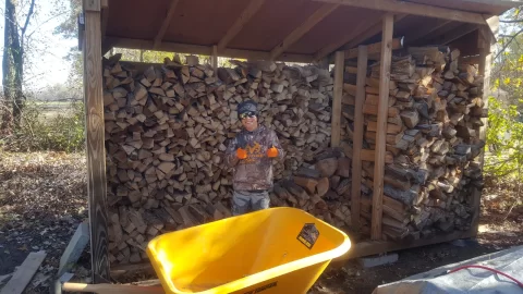

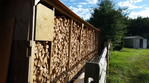

There is no real air flow. You need to vent the back and sides. The front opening should be facing the summer prevailing winds. Definitely stack off the ground. My sheds are a minimum of 8 inches up
To speed up your drying time you need air flow
This shed has removable back panels and vented sides with extended roof overhang
