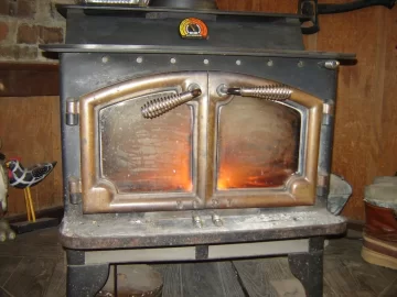

We have a lopi liberty pre-epa. Works just fine in our 1910's drafty home about your size. All depends on what you want your stove to do. Since your a bit South of my temps, you maybe needing a smaller stove. Liberty's can get a might hot! [Hearth.com] Wood stove advice Lopi Liberty or Republic 1750
