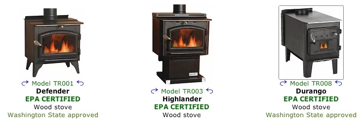

I want to go on the record here as saying that many newer vogelzang stoves are BOTH UL listed and EPA approved - some others are UL listed and EPA exempt. This means they were put through all the tests and passed. If, as Elk says, they are "death traps", then what he is telling us is that all the UL codes, standards and tests related to stoves must be deficient. Either that, or vogelzang is slipping money under the table to some test guy.
I say it is neither. I have looked at the current vogelzang models in the local hardware store and they certainly look as good or better than earlier King, Atlanta and other hardware shop brands. Certainly we would rarely suggest buying their 55 gal. barrel kit, but to suggest a vogelzang EPA UL unit is not as good as a Century or something else like that - well, there is simply no proof of that!
It's easy to dump on something, but I suggest we stop the generalization unless we actually have any experience with the current line. If Lowes and others are selling them, it does prove a couple things - that the company stands behind their products and that the return rate and trouble rate is low.
I lived in tents and shacks in WV and TN many years ago - would have given anything to have even a vogelzang cast iron box stove....instead, we had $25 used Warm Morning coal stoves that we threw tiny chunks into.
NOTE: The boxwood and many of their cast stove are NOT UL or EPA approved, so therefore cannot claim to be equal to or better than listed stoves.

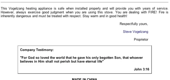

Also, consider the blessing put on these stoves - that is certainly going to out-qualify UL. After all, if our Prez listens to these "higher voices", then they must also be able to do wonders for your living room! Get ready - Bagdad is coming to a rec room near you!

We are talking about the stove mentioned in the post ,which happens to be the BX26. It states in its manual that it is not UL approved
All the other conjecture Web spouts, does not apply to this particular stove or the post in general
