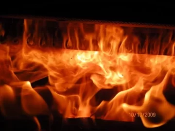

Have you had it this hot?
Zap
LOL. I had my Endeavor looking that way this morning. Per my "snug handle" thread, I adjusted my hinges to eliminate a tiny air gap in the upper left hand corner of the door. Now when I shut the bypass damper, holy hell! I get such a strong secondary that I begin to wonder if it will ever slow down! Of course it does settle down, but man what a powerful show!

Pagey stove top temp in that picture was 725 and the flue temp was 425.
