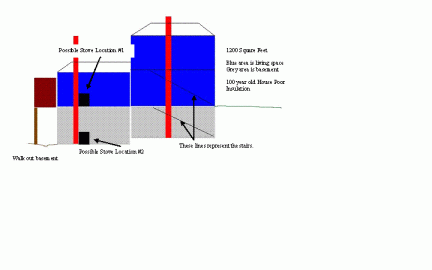

I am having the same battle. Basement or kitchen. Basement is a walk out the house is 150 years old with minimal insulating and the walk out door is wood and there are two big wood windows down there too. I have a propane heater in the basement and one in the dinning room on the first floor. I say heat from the kitchen with my brand new Napoleon. But some people say it burns hot. I am afraid it will blast me out of the kitchen. I have added a scetch for all to see. The two big red towers are my chimneys. The one that runs to the second floor has the furnace in it.
