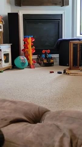

Ok that is an insert and it looks like you have a zero clearance fireplace of some sort. You typically can't use an insert in one of them. We would need to know make and model of the fireplace to know for sure
Mine is a napoleon and the insert is a drolet, I know I probably need pipes and obviously the wood stove but I didn't expect that price tag, I'm going to message the company the same thing I messaged you guys and see what they say. I was expecting 5k.
Yes we need the make and model of the fireplace. I am pretty sure what you have cannot have an insert put in it.
Looks similar to a Napoleon Ascent gas fireplace. If so, a wood stove insert can not be installed there.

The drolet you posted cannot be used in your situation. You don't have a suitable fireplace for an insert
I'm sure my local fireplace store can make it happen though? But it'll probably cost 15k like I got quoted.
No they can't for 15k. You would need to remove what's there and build a working wood fireplace then install the insert. The last basic fireplace I built from the ground up was about $25000 then you have the insert and liner ontop of that
