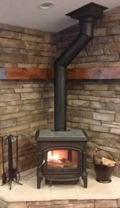

I was in the same boat as you - ZC prefab fireplace, 8" chimney (mine was air cooled), and wanting to replace that inefficient, air sucking piece of garbage with a stove. Ultimately there was nothing I found that I could salvage from it. I ended up ripping everything out of that corner of my house, removing the chimney, patching the roof and ceiling, and putting the new 6" chimney farther away from the corner as trying to reuse the existing holes from the old chimney wouldn't have met clearance requirements to walls and trusses for any stove/6" UL 103 HT chimney system I could find.
I definitely found several issues from the original install - in several spots they weren't even meeting clearance requirements for that specific prefab fireplace and chimney system. I can't imagine hooking a stove up to it. Sometimes you get lucky, but I sleep much better at night knowing I put the new stove and chimney in and followed all clearances and installation requirements to a T.

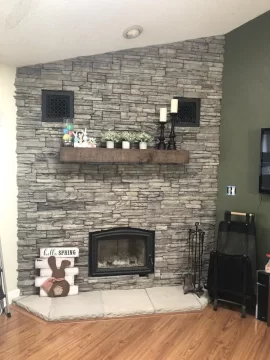

I am in the same situation. ZC Heatilator, corner install. I am just going to wait another year or so to save up for the install. Hoping to just get a new high eff ZC fireplace from Valcourt/Osburn/Astria. The site is too small for the larger fireplaces. Not sold on a stove for this corner, unless something comes up during planning that there is an issue, and can't fit a fireplace. Guess i'll get some quotes to budget this out. Maybe i can do some of the demo to save some money when the time comes.

Yes if the pipe isn't UL listed for the stove/fireplace its worthless. Either its a new high eff fireplace with new pipe, or gut the whole area and install stove with new chimney pipe. Think i can get my area to look like one of these two choices. The FP16 would fit in my spot, its on my list. All the ZC fireplaces i am looking at use 6" packed pipe. My pipe has to go thru the attic. I really like the fireplace look.
