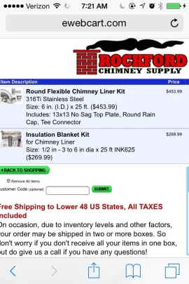

I think I am buying a Jotul which has a 6" opening so I would need to buy a 25' liner with a 6" diameter correct? Also, the stove will be entering the chimney horizontally so I believe I need a tee connector. What is the difference between liners? Obviously I do not want to do a rigid liner for working way down the existing chimney. Below is the setup I was going to buy. Any advice? Thanks.

Hi fellow Jersey guy, yes 6 inch is pretty standard. My encore required 8 inch if run with doors open in front but I never do that. I could have used 6 inch but my masonry block was 12 x 13 and I opted on 8 inch. The flex is the way to go in my opinion. If you call chimney liner depot they are VERY helpful in what you need. They sold me a kit with what ever I needed including top cover that flips open to brush down from top plus the T for bottom that has easy remove bottom cap to remove for inspection and collecting . They also sold me a poly brush for liner cleaning

So what is the actual difference between the 316 Ti liner I propise up top and the Hd liner from chimney depot? I'm assuming the HD liner is just a bit thicker?

It is allot thicker, has a smooth wall, is more flexible, has a smaller outside diameter, and is very different construction.

The depot has both on their site. The HD is thicker and smoother

Also for wood you really dont need to pay the extra for 316 304 is plenty for wood if you were going to use coal oil or gas in it you would need 316 but not wood. Heavy wall is a continuous interlock and light wall has ribs and then a crimp. I have never pulled a heavy wall apart but have a few times with light wall. I have also torn light wall when installing it and you are not going to do that with heavy wall
Ok well it looks like I am going to go with the heavy wall from the depot. Thanks for the help. I was about to buy from Rockford.
