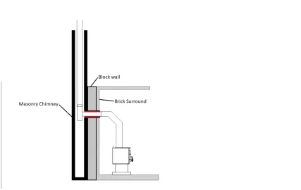

I'm planning out my wood stove install. One thing that I was wondering about is the connection between the T and the stove pipe. The hole in the brick surround for the stove pipe is 8" diameter and the T for my 6" flex liner that comes through the masonry chimney/block wall/brick surround is 6.25" diameter. Should I just stuff in rockwool around the T pipe to fill the gap?

I realize my description might not have been the best, here is a quick mockup I did of what I am trying to describe. The area in red is what I am trying to figure out what to do with. The area between the T pipe and the opening, should I fill with Rock wool or other alternative?

Ok. I think you can do that yes. @bholler would know for sure. You can (I have) a metal ring around the stove pipe and against the brick, blocking the view of that part.
No fiberglass. Rockwool (something rated to high temps; fiberglass is not).

Yes I have a cover plate for that. I am mainly wanting to support the T (if that is even necessary?) and also stop cold air from getting through that 1" space around the T pipe.

It should be stuffed with insulation. We usually use scrap insulation left from insulating the liner. We then mortar over that insulation.

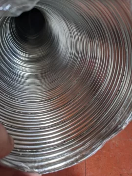

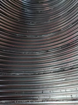

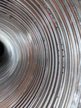

I have a quick question about the liner. I had read about some liners are directional, but I don't see anything about that in the instructions for this liner. Are you guys able to tell if this is directional or not?

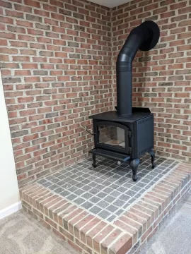

Got it all installed! I just have to screw the stove pipe together, then can get the final county inspection before I fire it up.
I did not have enough of the insulation left over from the liner install, so I just stuffed the cavity with rockwool I had leftover from another project.

Clean looking set up!
Happy burning. You do have dry wood?
That looks awesome, nice job. Keep us posted on your first couple of burns…
