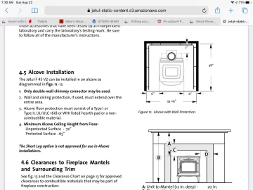

Jotul F45 v2 looks like it might work. I’m sure there are others but it’s the first one that came to mine. Note you can’t use short legs. quick answer, might not be the best option but it was my first thought. Keep looking. Check out the cleaning procedure. It’s not quick.

The F45 is a good fit for that sized area. It fits width-wise and just squeaks in for alcove height.
