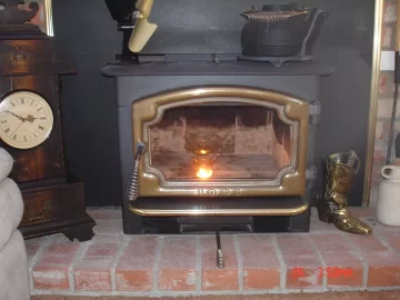

No it's not too hard, most of the time. It will depend on the model of the stove and the height of your roof. Can you post a picture of the stove, or describe it?

I will see if I can put up a picture. Back in a few.

No! That surround must be pulled off. The access door only allows the sweep to clean off the smoke shelf. Creosote is falling behind the stove. He also isn't cleaning the smoke chamber above the stove. It needs a liner, then the smell will likely go away.
By the way, your stove is a Lopi Revere. It's a good heater, even better with a liner!

As it is, the stove is venting through the huge fireplace and smoke chamber. It's designed to have a liner attached to it.
And your blower is missing, do you know what happened to it?
