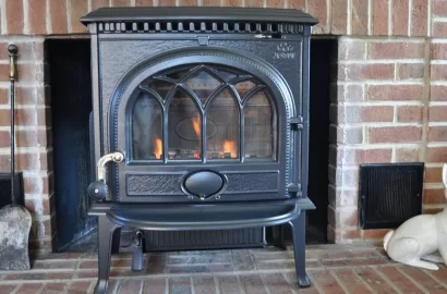

I just had a jotul installed on my hearth . You can't see it in the photo but there is a hearth extender in front of the stove ( 18x48 ) . This is a smaller stove for weekday evening fires and all weekend burns . The installer ran a new stainless liner up the existing chimney .

I saw some hearth installs, we don't really have the room for that on our hearth. I suppose we *do*, but it'd be pushing it, plus we've got 4 kids, and another on the way so the more offset we can have from the front of the hearth, the better.
So basically though, if it fits in the LxWxH it should fit, as long as I can get the chimney pipe installed without some major twists/bends?

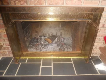

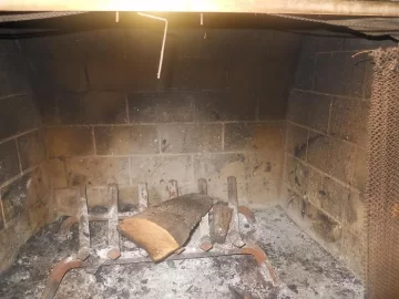

I took 2 pics of it, with the old glass still on it from the previous owner (it's rusted b/c they sprayed an oxidizer in the house to kill any mold that may have still been around, they had to remediate the basement a while ago, well before we moved in).
So, the overall dimensions I'm looking at are:
Width - 40"
Height - It's an arch, about 22" at the shortest (on the ends), about 23" where a normal insert would be, and it goes up to about 25ish inches in the dead center.
Depth - I believe it's 30" deep, it was in my head till about 10 seconds ago, then I forgot what the measurement was.
Note the tape measure at the bottom if you need a relative perspective.
Oh, and yeah, the previous owners left this mess in here, we moved in around April and didn't get into it yet.

If you can swing it I'd go for the insert. My insert, and others I have seen are setup so that even the relatively delicate fans and wires can reside right below the firebox meaning the floor and sides of the insert don't get that hot. It would concern me to place a stove directly on any surface even fire brick. Maybe it can and has been done but I would check that out carefully.

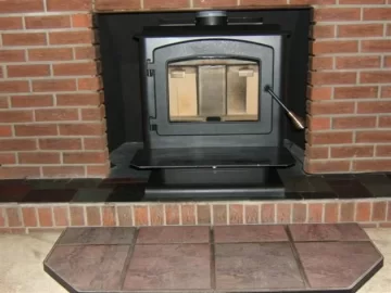

I was on a tight budget and bought the osburn 2400 insert. It was the biggest firebox I could get for the money. Bought at dynamitebuys.com. I am very happy with the unit. As advised by the others, you are going to want a larger firebox. Good luck.
Had a regency insert in this fire place for 10 years. worked good but then retired it and put in a regency R-3 free stander in its place. Worked even better but the firebox was a little small for my sq. ft. So, decided to get a heat monster NC-30 and stuff it in there. Should be really good this winter.................
